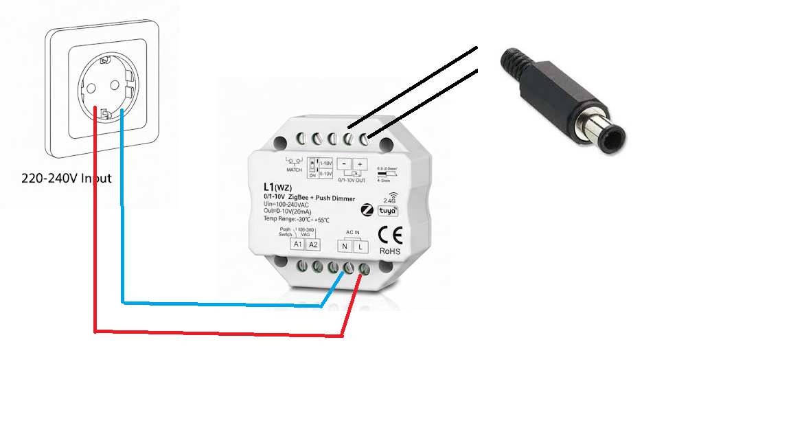

I’ve sketched out a diagram like the one in the attached image. Does this make sense to you?

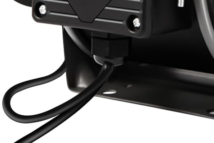

Of course, just don’t expect the black plug to fit any where. You’ll need to open the side of your ventilator to see where it needs to be attached
The fan control interface uses a connector similar to a standard DC power adapter plug, and its use is optional.
ah… pictures i saw didnt show that. well done investigating!
