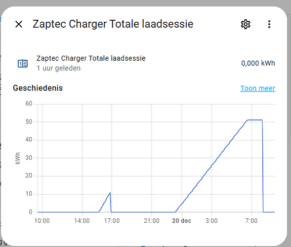

It does have an other entity which updates very regularly but that one resets after every charge:
Update 2: Yeah, adding this second entity instead completely screws over the energy dash, I get many more negative outputs. So not sure what I can do about it

Here you can make an utility meter with periodically resetting checked. That should fix the negatives.
When you say periodically resetting, it will still have negatives when it resets, no?
And you would add an utility meter in the config file using this second entity which currently resets after every charging cycle?
No it wont :+1:
Yes the totale laadsessie and you can add them through the helper tab under devices.
