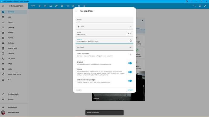

I am using Aqara door sensors for both the doors but for the garage door it doesn’t have a binary sensor. Instead there is only a cover sensor available and that can’t be included as a binary sensor in the automation.
So, can you guys, please help me in converting or duplicating my Garage Door Opener (Cover sensor) into a binary sensor so that I can include it in my automation and make the automation work.

In configuration.yaml
template:
  - binary_sensor:
      - name: Garage Door Status
        state: "{{ is_state('cover.ratgdov25i_db38dc_door','open') }}"
        device_class: garage_door
