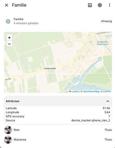

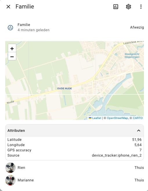

Hi
I did exactly that but my group keeps stating not home, while but me and my wife are at home.
Any tips or hints?
Check the state of the devices that are assigned to your persons. Assign that one which shows the correct state. If you assign multiple devices that one with the last refresh will be taken.
