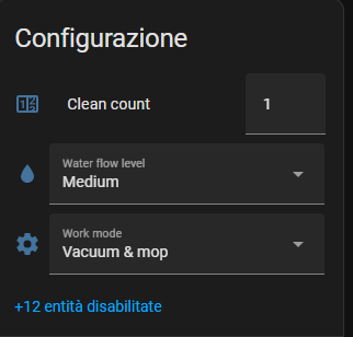

you can, you should have the “work mode” select like this in the attached files
I got it now :slightly_smiling_face:

step 1.set work mode
step 2.send command
