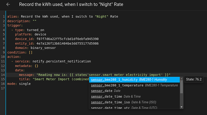

As a small learning step, I’d like to display a number in the Notifications. This is my (non-working) yaml:
A couple of questions.
  1. What would be the correct command to read this sensor?
  2. Why is the sensor I am hoping to use not listed in this pop-up?
Regards, Martin

If you test Reading now is: {{ states', it would have tell you what was wrong because states is a function that require a parameter.
And parameters are surrounded by parenthesis.
Why is your sensor not in the list? I can’t tell because there is a scroll bar and s is after d in the alphabet.

Understood. But I wanted to show the (incomplete?) drop-down list. And on that point, the list is not very long and does not go beyond d.
Ok, if you go to developer tools > states (My HA is not in English, you might have to search)
Then, in the filter entities box, start typing smart_ does it show? If yes, copy/paste
