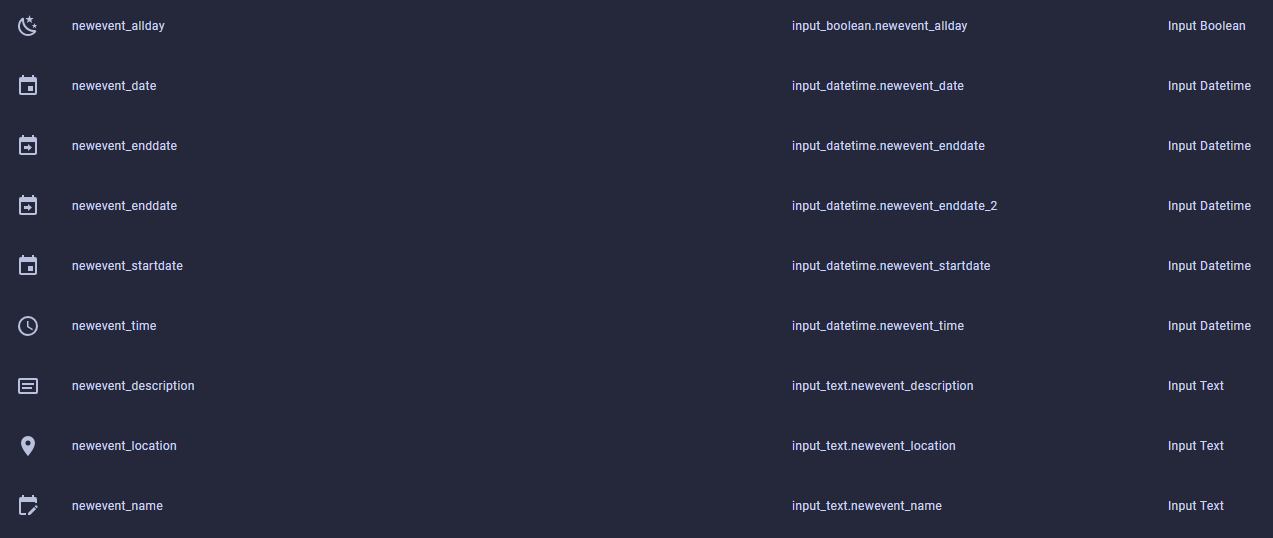

Could you also help me create the input fields? can I do it from config.yaml? Do they have to have any particular requirements? Thanks
Apologies for the slow reply. I actually created mine via the UI. (apparently the preferred way of doing things!)
Settings > Devices & services > Helpers. Click the type (input boolean = toggle, input datetime = date and/or time, input text = text)

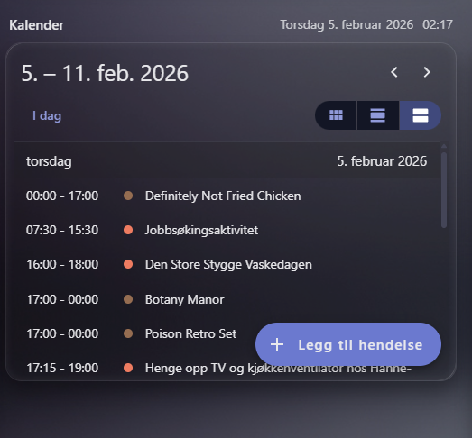

Oh happy days! This has been automatically added, I think as a feature in 2026.2. I use the regular calendar card with my google calendars, and noticed an “Add Event” button (“Legg til hendelse” in norwegean) today on the card today. Shows a dialogue popup with the usual fields, works great. Also, It seems I can also delete, but not edit, events.
