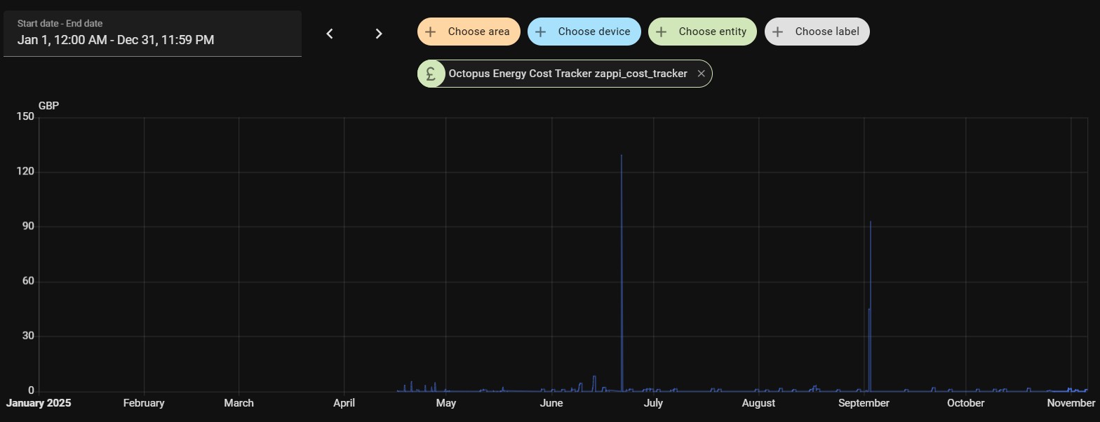

I thought this would be straight forward, but I cannot seem to get anything to work. I would like to create an entity / cost tracker … which shows my cumulative spend on EV charging over the year. I have a MyEnergi Zappi Charger installed, and integrated with Home Assistant, and can see that there is an entity for “Octopus Energy Cost Tracker zappi_cost_tracker” which shows a graph (as attached) across the year … but cannot figure how to create a sum entity … to just add all this up.
I did create a helper utility meter entity … but, not sure if I did it right … as just shown “unknown”

Try a statistics graph card instead of the history panel, that should present the total in the way that you are interested in.

Apologies … from what you have said … I actually think my “utility meter” entity is actually working, but I was expecting it to “sum” for the whole year … but it seems to only be “sum” from when it was created
