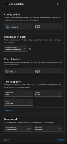

The assistant I created:
This assistant works fine from the web console. I can use chat, sst works with the little microphone button to the right of the chat box, and tts works as the assistant replies to me.
The issue is with the wyoming satellite. From the playback container I can speaker-test or aplay and I hear it from the USB speakers plugged into the pi. From the mic container, I can arecord output.wav, then playback the output.wav and I heard it.
However with everything running as shown above, if I say my wake word nothing happens.
I know I’m missing a piece of the puzzle I just can’t figure out what – if anyone could help I would be very appreciative.
