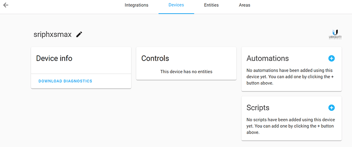

I still see this device listed via Configurations → Devices & Services → Devices followed by a search for “sriphxsmax” as shown in this next screen shot.
Then when I click on this device named “sriphxsmax”, see the following screen shot.
Clicking on the pencil results in this:
It doesn’t seem to matter if I disable or enable the device, I’ve not been able to figure out how to actually remove this and other orphaned entries through HA.
Oh, so sou see the devices for all of your current Mobile App logins but not for the orphaned one?
Then something seems to have gone wrong, I was able to see an old phone I didn’t use for over two years there and was able to delete it.
This is the usual way, but if that’s not possible in your case I guess only editing the db manually remains. Afterwards, it should work that way, though!
This screen shot shows that this device is still coming from your Unify Network integration and not Mobile App.
Right, it indeed is not part of the Mobile App, but is part of the UniFi Network integration.
I cannot delete it from there either? I’ve disabled the device, but still no options to delete it. I’ve gone into my UniFi controller and searched for the device name, it’s no where to be found there.
Any other ideas?
