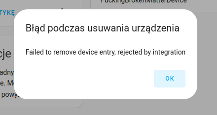

I’m wondering if using the DELETE button tells the Matter Server to decommission the device properly, so you don’t end up with tons of “failed to intervew node #” messages in the server.
For me it refuses to delete it:
Had to remove the matter integration to finally “forget” the device, it was the first one so removing it in whole addon was fine. Then removed broken Matter integration.

If I try to delete the devices, I get the same error, saying rejected by integration.
If I delete the Matter integration, they are gone. When I add back Matter integration, they reappear.
