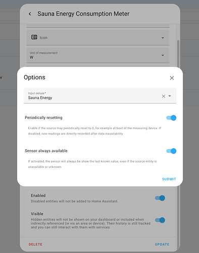

  1. create a template sensor
  1. Create a utility meter for that template sensor
Tadaaaa
