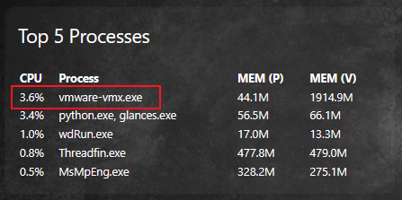

I didn’t realize that I already have access to this info via Glances which runs on my Host OS. I was able to identify the HA VM by looking at the respective “command-line” for this process in Windows Task Manager/Glances API response: Specifically:
"C:\Program Files (x86)\VMware\VMware Player\x64\vmware-vmx.exe" -s "vmx.noUIBuildNumberCheck=TRUE" -# "product=4;name=VMware Player;version=17.0.1;buildnumber=21139696;licensename=VMware Player;licenseversion=17.0;" -@ "pipe=\\.\pipe\vmx55defce9cfb53d59;msgs=ui" "C:\Users\MKANET\VMware VMs\HA\HA.vmx"
The card I made below recently is comprised of several different Glances sensors for each process’s CPU utilization, physical Mem, and Virtual Mem:
