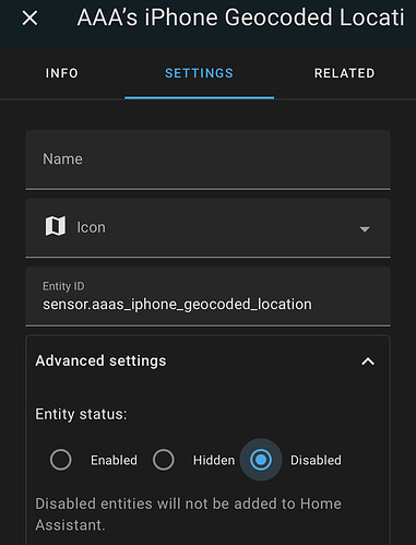

Unless something has changed since this thread, there is no service to disable entities and it can only be done in the UI. Automation to disable/enable entity?
