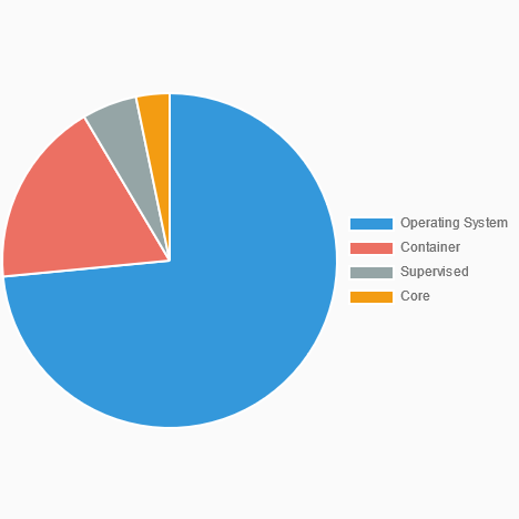

Still, I’d be avoiding Supervised installs. The devs hate it. If this grey wedge gets small enough I wouldn’t be surprised if it gets dropped as an official installation method (no there are currently no plans to do this, and this is just my opinion).
Screenshot 2023-12-03 at 08-56-00 Installations Home Assistant Analytics
Of the 4 options available, supervised is the best for my use case and has treated me well over the past 2-3 years. As mentioned in the thread, container loses some capabilities that I require (it was the first method I installed by), including the add ons feature. OS install limits greatly what I can do with the system at an OS level (I lock down devices heavily on the network and also have custom system level logging and such that the OS install would prevent me from doing, as I’ve tried to use it before), and the core install is basically just a less useful install method than container. Supervised is honestly the only option that meets all my personal requirements for HA to function and also give me my freedom to control the system the way I want.
