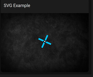

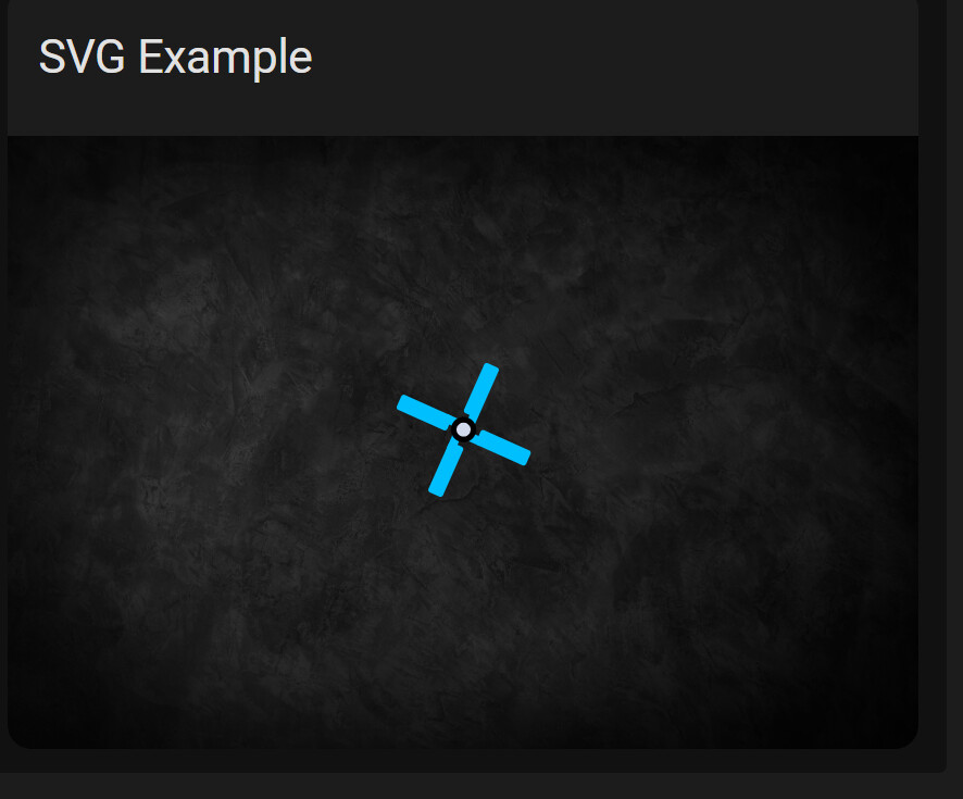

Just add an image element with the corresponding SVG file path
type: picture-elements
elements:
  - type: image
    style:
      left: 50%
      top: 45%
    image: /local/animated/forward16.svg
title: SVG Example
image: /local/pics/black-bg2.jpeg
The SVG I used in the example is also animated and rotates. The image element also allows you to assign an entity to the element and utilize tap actions.
