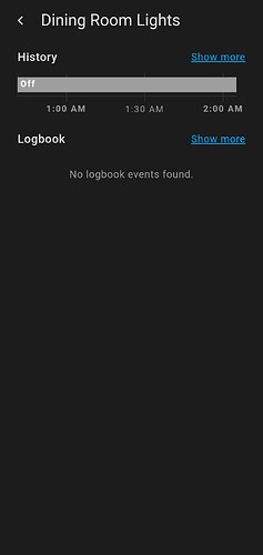

There is a service called Recorder: Purge entities that you can use. I just tried it and was able to successfully delete my history on my light switch. You can access this service by going to Developer Tool > Service page or by selecting call service in the action section of your automation. This was my first time using it so I don’t know much about the service but there is documentation you can refer to. Recorder - Home Assistant
