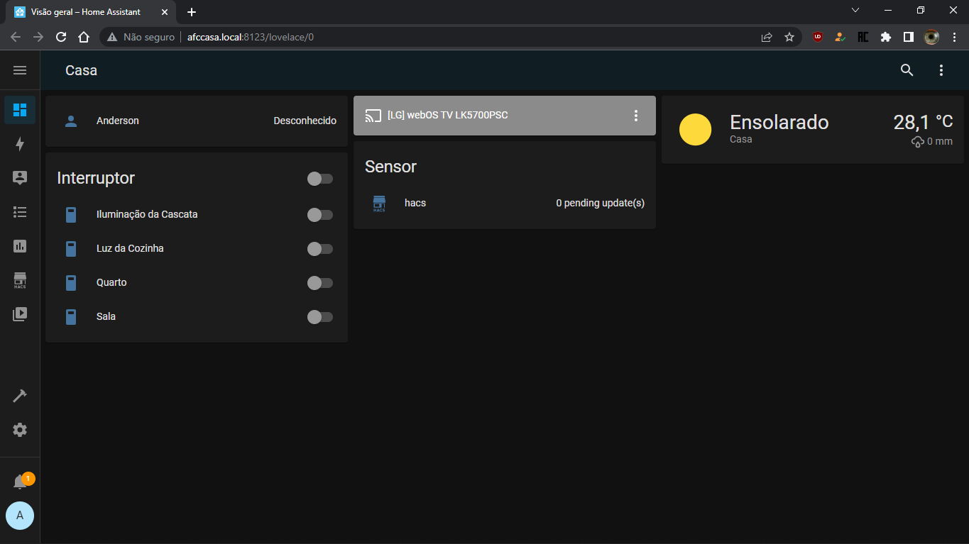

I’m already able to access through port 8123 and I’ve already managed to configure my lights:
