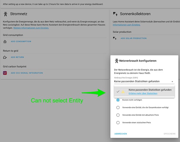

Hello, i have some trouble setting up the new Energy Dashboard.
I can not select the entity.
Here the Configuration:
What did i do wrong?
Thank You!
My problem has been solved :slight_smile:
