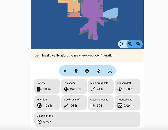

How to extract coordinates using xiaomi vaccum map card?
I already added the vaccum map card and here is my configuration
vacuum_platform: Roborock
entity: vacuum.roborock_s8_maxv_ultra
map_source:
  camera: image.roborock_s8_maxv_ultra_map_0
calibration_source:
  camera: true
However I don’t seem to have any option to send the vaccum to a designated spot on the map
I don’t have a zone cleaning option like in the following post Roborock S8 with Xiaomi Vaccum Map Card - #6 by faspina
I don’t use this card, but looking at the docs, I think I see your problem:
You’re specifying a camera as the map_source, but then using an image entity. The demo config shows a camera.xiaomi_cloud_map_extractor entity being used:
map_source:
  camera: camera.xiaomi_cloud_map_extractor
You’ll probably have to install the Xiaomi Cloud Map Extractor to get that entity.
Correct it pulls the info off the hot and stuff the detail in the map attributes. The card also CAN send a bot to a spot to clean if the cloud map extractor is installed and supports your bot.
Must I use the cloud map extractor? I have a roborock s9 maxv ultra which is not supported by the xiaomi home app
I don’t know, sorry. Like I said earlier, I don’t use that card.
However, you say you have the s9, but the yaml you posted above references the s8. Is that a typo or something?
