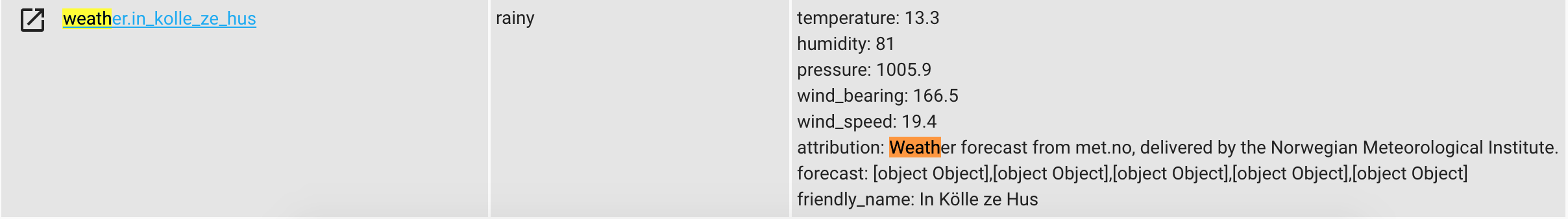

First a maybe stupid question: What is the “dev-info panel for details”?
Because that’s the message I get with the entry in my sensors.yaml shown below.

When I put weather_in_kolle_ze_hus instead, the syntax is okay, but I don’t get the values…
