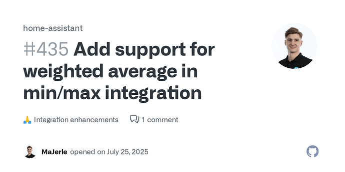

I’ve added the feature request to support weighted average.
