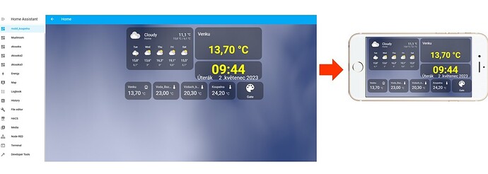

What is the best way to fit a dashboard on an iPhone screen? The screen resolution is 1334x750

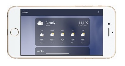

I was playing with it yesterday but was not successful at all (tried many options), but nothing worked at all:
SnĂ­mek2
Is there any trick? Can someone share yaml code so I can get inspired, please?

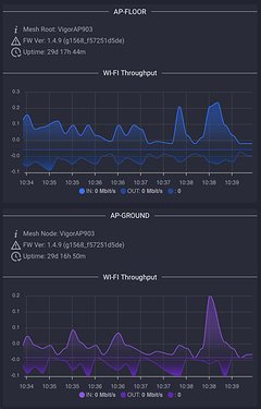

and the same dasboard on iPhone. Sorry for fragmentation, but for some reason whole page screenshot in Safari on iOS does not work with HA. In reality it is one continuous page:
