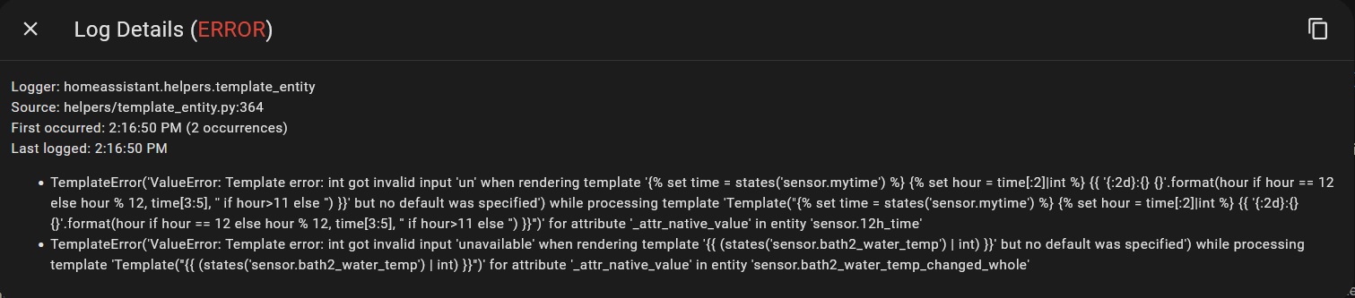

How to fix but no default was specified
I’m getting this Logs error but the template does work. Can anyone telll me how to define a default?

It’s the int filter. Change it to something like int(0) where 0 reflects the default.
That worked ! Than you !
