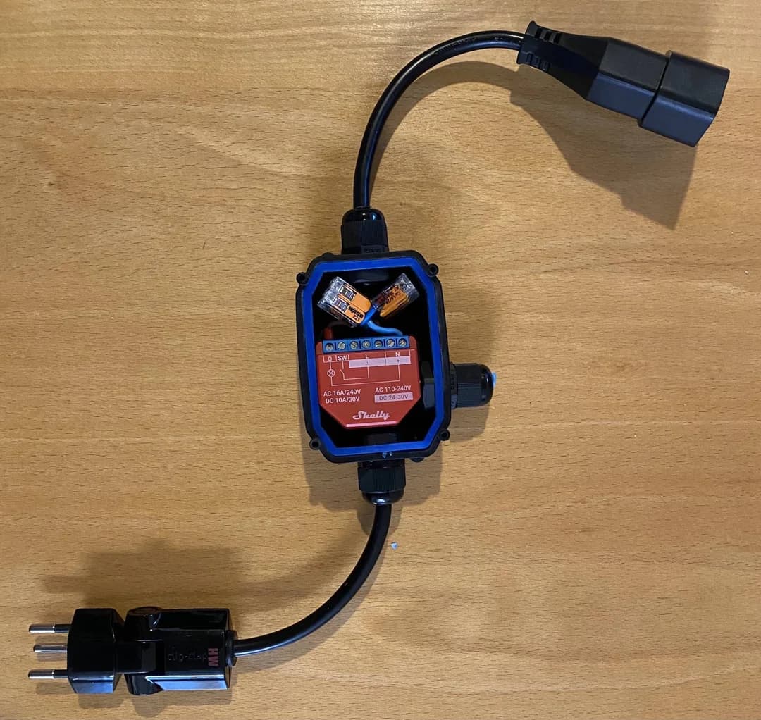

You could do something like this
but with a zigbee clamp meter in the box:
