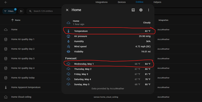

These are obviously different. The values I want though are in weather.home as seen in the picture below:
So my question is, how do I pull those three things out so that in my code below it will give me the current temp, what the high of the day will be and low.

ah. ok. if they are disabled sensor entities, you’d likely find them in the devices tab. like this:
where it says ‘+11 entities not shown’, hit that and see the list of provided but disabled sensors. as i said, i don’t use accuweather so i cant say what sensors they provide. but that’s where such sensors typically are found.

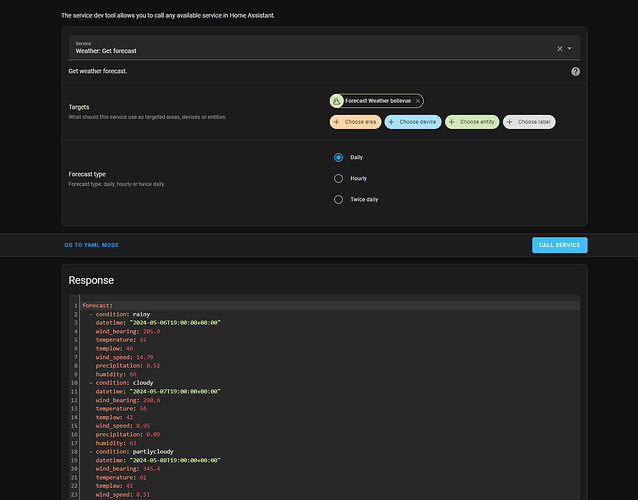

btw… the other thing you can do to make sure the call itself works is to go to dev-tools->services and do the get_forecasts call and make sure it is indeed actually fetching data. doing this will help you verify that you are getting the data but just that you need to shove it into the right sensor… here’s an example for my setup:
Afaik the unique_id is not determining what the entity_id will be, the name is. So the entity that was created is should have the entity_id sensor.todayhightemp
Yep, that works, so the call service is working.
