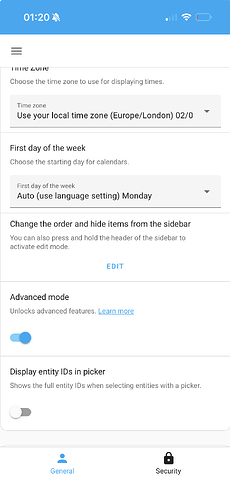

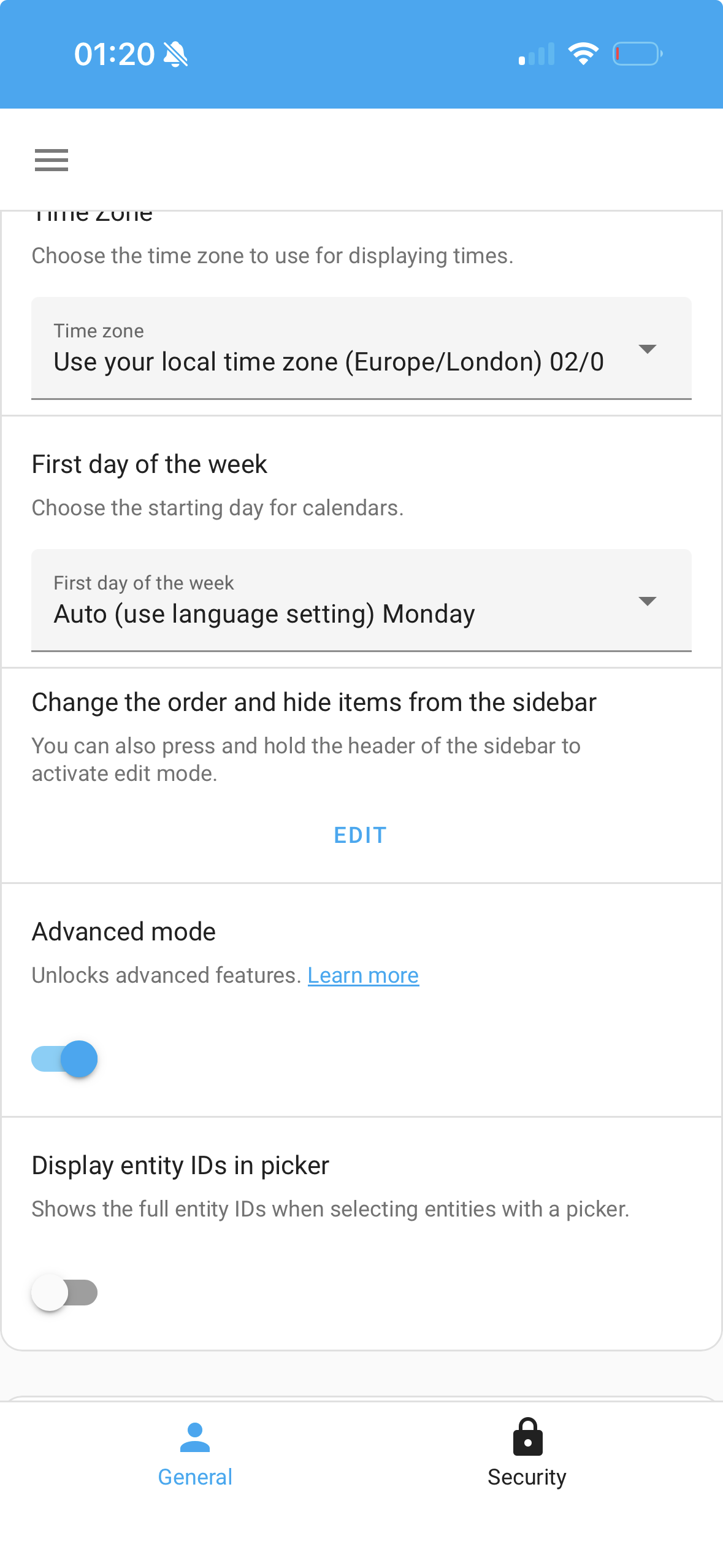

Alright, this is solved. For future reference: I needed to enable Advanced Mode for my profile. I then got an extra ’Advanced configuration’ page, where I could include devices which should show triggers in HomeKit.
What is Advanced Mode and what profile are you talking about?
You need to import the blueprints he mentioned and then create an automation from that blueprint with the buttons as the device.
You go to your own user profile in HA and flip the toggle for Advanced Mode.
Then, when you go through the process of adding devices to HomeKit bridge you get an extra step at the end where you can add the triggers created in that automation. Those are the buttons you can use in HomeKit. Each component like short press, long press, long release for each button will be available as buttons in HomeKit.
