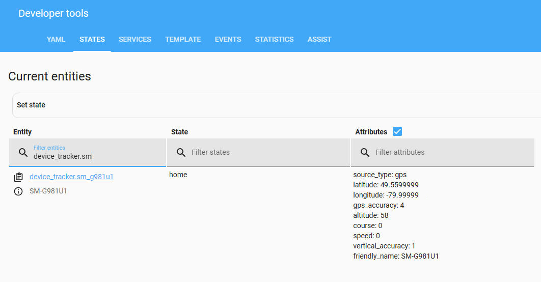

Since it looks like Life360 is toast, I have subscribed to Nabu Casa for, among other benefits, the device tracker. I have my phones entity which shows the latitude and longitude attributes:
How do I get this location to show on my Map?
