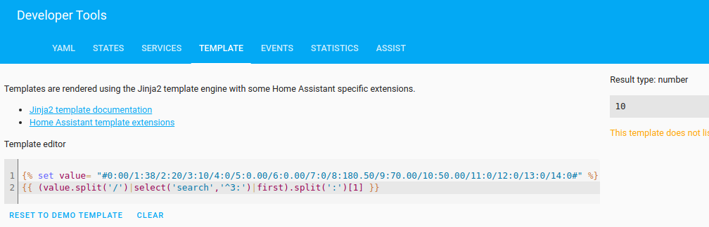

That’s not JSON. Do you mean you’re trying to extract the 10 from here?
#0:00/1:38/2:20/3:10/4:0/5:0.00/6:0.00/7:0/8:180.50/9:70.00/10:50.00/11:0/12:0/13:0/14:0#
If so:
- name: "Minute"
  state_topic: "Device00"
  value_template: "{{ (value.split('/')|select('search','^3:')|first).split(':')[1] }}"
I have searched for the item starting with 3:, but if you know it’s always going to be the fourth item, you can use the simpler:
  value_template: "{{ value.split('/')[3].split(':')[1] }}"
oh, great, thank you, it worked
