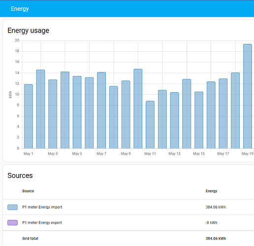

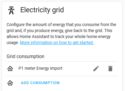

Once you confirm the results are of expected, you run the command on the statistics table instead of stattest. Next head over to the Energy dashboard to check the results.
Before
After
You can remove the old sensors from the grid configuration at this point.
