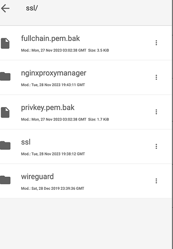

the PEM files are gone…
Go to the ssl drop down. do you already have a cert??
Recall that this all worked w/ Letsencrypt. So the domain stuff is nailed down.
