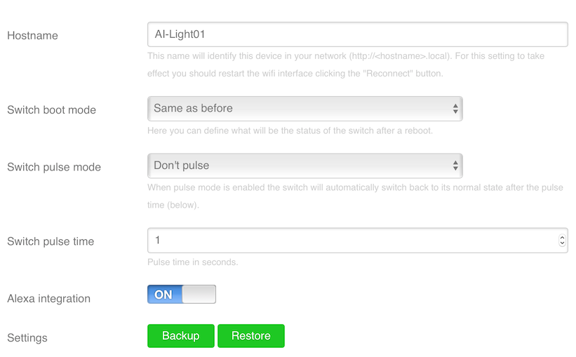

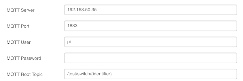

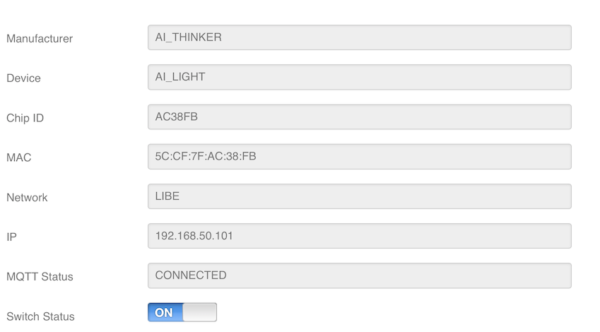

I have problem to get the MQTT to work, when I eneter the commands (see below) nothing happens. I have configured the bulb and I can see in status site that the MQTT is “Connected” but when I try to send commands from my RPi with Hass and Mosquitto.
This is the commands I did try sending from my RPi
mosquitto_pub -u pi -P xxxxxxxx -t “/test/switch/AI LIGHT_AC38FB/relay/color” -m “#FF0000”
mosquitto_pub -u pi -P xxxxxxxx -t “/test/switch/AI_LIGHT_AC38FB/relay/color” -m “#FF0000”
mosquitto_pub -u pi -P xxxxxxxx -t “/test/switch/AI-Light01_AC38FB/relay/color” -m “#FF0000”
mosquitto_pub -u pi -P xxxxxxxx -t “/test/switch/AI-Light01 AC38FB/relay/color” -m “#FF0000”
There’s no error message and my ‘/var/log/mosquitto/mosquitto.log’ is empty
The curl commands works fine, it’s just the mqtt that I can’t get to work.
Here’s some info for my system
chip id: AC38FB
hostname For the bulb): AI-Light01
RPi: IP 192.168.50.35
Here’s screenshots of the bulb
Does anyone have any idea what could be wrong?
Does your MQTT broker require authentication? If not, then leave the MQTT user field blank.
Publishing messages without a username/password (with authentication enabled), results in nothing :slight_smile: Your messages disappear in nothingness

I found the problem, as I have changed the hostname to AI-Light01, AI-Light02 and so on
then I don’t need the chip ID. I just put the hostname in command,
so in my case it should look like
mosquitto_pub -u pi -P xxxxxxxx -t “/test/switch/AI-Light01/relay/color” -m “#FF0000”
