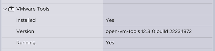

Seems in meantime Open VM Tools were updated. Currently I have:
Screenshot 2024-02-17 at 17.19.18
I do not see issues like that, but I’m running HA on ESXi 8.0.
EDIT: Upon checking it also seems to be the most recent version available.

open-vm-tools are included in the image. This is on 8.0.3 24280767
HM, this is strange. Are you using vSphere? I('m on ESXI free host 8.0.0 and it looks different:
Screenshot 2024-11-26 at 18.43.30
Screenshot 2024-11-26 at 18.41.14
Clearly it shows Open VM Tools being installed and not managed by ESX host.
Perhaps something changed in meantime, my installation is ~4 years old and was just updated from version to version, so maybe Open VM Tools were installed when I did the first install and now are maintained, while it your case it looks like using VMware original tools?
Anyhyow it come with ova image and no additional action was required.
