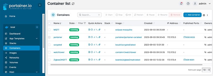

This is how my Portainer looks.
Now back to this guide, after i created the zigbee2mqtt folder on /home/pi i downlaoded the config from wget https://raw.githubusercontent.com/Koenkk/zigbee2mqtt/master/data/configuration.yaml -P data and edited it with correct info as its being written in the guide.
Then i proceed to create the container for it in Portainer but when it comes to map the volumes, i cannot see home/pi/zigbee2mqtt/data and /run/udev in the drop-down menu (see the picture).
