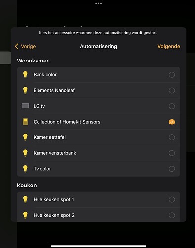

Include this input_boolean in the HomeKit configuration
Can someone please tell me where to enter this?
In the configuration of the Homekit Bridge Integration make sure to include “Input Boolean” under “Domains to include”.
Depending on your inclusion mode you have to either select (when inclusion mode = include) or deselect (when inclusion mode = exclude) your newly created input boolean on the next screen (after pressing submit once).
After that your input boolean will appear as a switch in the Home app

I must be missing something very obvious here but I don’t understand how to set up the HomeKit side.
The instructions refer to the “Homekit” app which I figured was the Shortcuts app based on the screenshots and I can create the shortcut and get it to update the sensors in HA but I cannot figure out the automation part, where do I find this “Accessory Automation” on the Homekit side?
Basically I have no idea how to get this screen:
You go to the Home (Maison in French?) app to set up the automation.
What it is: the HomeKit_sensors_update Boolean sensor is the trigger for HomeKit to run the automation (so every 2 minutes, HA sets that sensor to true, and youve exposed that sensor to HomeKit and then the automation in HomeKit gets triggered and runs the automation)

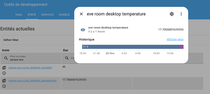

Thank you very much for your help. Unfortunately, it seems that it still doesn’t work. I have doubts about the configuration of my sensors in sensors.yaml because I can’t find them in HA. What do you think?
- platform: template
  sensors:
    eve_room_desktop_temperature:
      friendly_name: "Eve Room Desktop Temperature"
      device_class: temperature
      state_class: measurement
    eve_room_desktop_humidity:
      friendly_name: "Eve Room Desktop Humidity"
      device_class: humidity
EDIT:
OK it looks like I can see them in my entities list now. But I have this error message in my dev tools:
Also, it looks like it doesn’t update the sensor value. Even if the HA automations executes every 5 minutes.
Do you know how I can:
  1. Reduce the number of decimals (I would like 17.7 instead of 17.7000007629395)
  2. Have a graph to display the history like this:
:arrow_up: Basically, this is exactly what I want to achieve with my sensor.eve_room_desktop_temperature
First: You don’t need to set up a template sensor? (it’s not in the instruction :wink: ). You send the necessary info in the URL. Check my screen shots in my earlier posts.
Second, to get it as a graph: also check my posts, you need to set up the HomeKit automation differently. So where you do the “get contents” part, and you add state to the main-part, make sure you use that as a number, not as a text field. So remove state from your command, add it again and make sure you add it as a number.

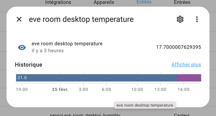

Hi @ChrisM1983!
I removed my sensors and double checked that I have configured state as a number (what I already did).
Now here is what I can see on my dev tools :
Still don’t have graph and can’t round to the nearest tenth :frowning:
Where is the get contents part for the temperature sensor? I’m doing it for humidity and temperature.
