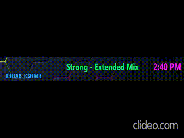

I am looking to have scrolling text (name of the current playing song) scroll if it doesn’t fit in the text space (card), keeping the space 100% full at all times. In other words, when it scrolls, it only scrolls until the last character is visible. Then it stops scrolling for a brief pause, then scrolls the opposite way until the first character can be seen in the card. Then pause, and repeat… I can’t figure it out.
Attached is the code I have so far that is close but not quite there yet.
