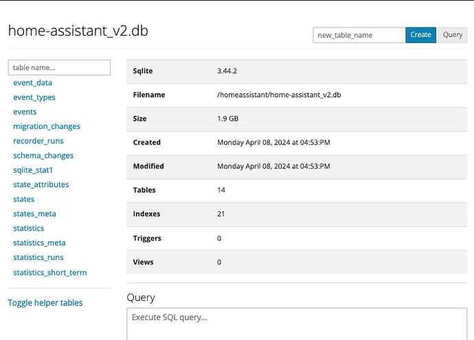

My database is 1.9GB
When I use this query
SELECT
  COUNT(state_id) AS cnt,
  COUNT(state_id) * 100 / (
    SELECT
      COUNT(state_id)
    FROM
      states
  ) AS cnt_pct,
  SUM(
    LENGTH(state_attributes.shared_attrs)
  ) AS bytes,
  SUM(
  ) * 100 / (
    SELECT
      SUM(
    FROM
      states
  ) AS bytes_pct,
  states_meta.entity_id
FROM
  states
LEFT JOIN state_attributes ON (states.attributes_id=state_attributes.attributes_id)
LEFT JOIN states_meta ON (states.metadata_id=states_meta.metadata_id)
GROUP BY
  states.metadata_id
ORDER BY
  cnt DESC
And then make the sum of the bytes column in a spreadsheet I have 696.367MB
How can I find out where all other disk space us used?
