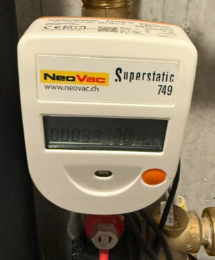

I would like to integrate my cold and hot water meters into Home Assistant.
This is the meter model I am using, including a photo for reference:
Both meters are equipped with a reed contact, which is connected to a Superstatic 749.
According to Neovac, the Superstatic has not a M-Bus interface, but for the 433 MHz radio transmission the encryption keys are not provided, so accessing the data wirelessly is not possible.

If it took 749 out, it was likely wired improperly. The manual linked says 749 input has 2Mohm pullup at 2.3V.
But even if correctly set up, it’s fragile approach with 3.3V Esp. Some comparator ic or BSS138 might work…

Starting point
• A cold-water meter reed contact is wired into a Superstatic 749 (two conductors: red/white).
• Goal: read the same reed pulses in parallel with an ESP32 (ESPHome) without breaking pulse counting on the 749.
