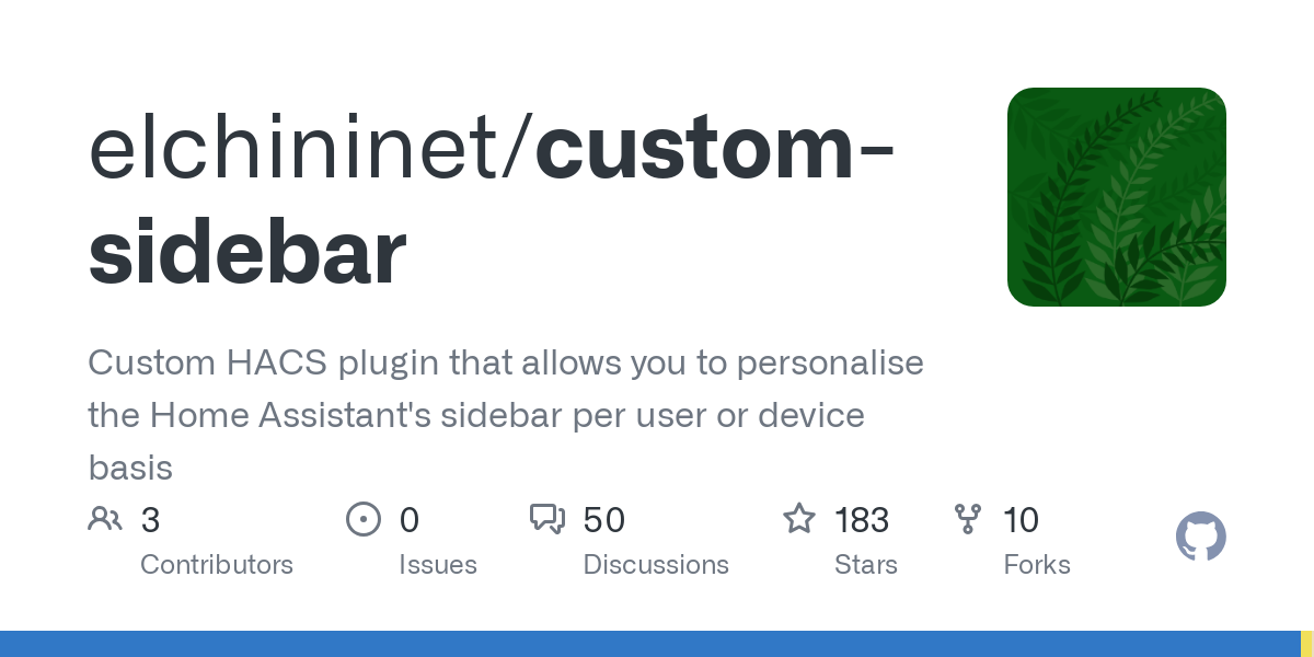

A potential custom option
allows you to personalize the Home Assistant’s sidebar per user or device basis

I came here looking for the same thing.
Thank you @LiQuid_cOOled I will personally give this shot. Not ideal to use a mod to solve a problem but maybe the amazing devs can give us both options in a newer update.

Custom sidebar is one solution, a lovely mod that delivers alot of powerful features that unfortunately goes underutilised on my setup.
