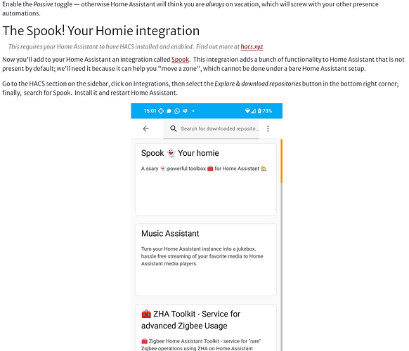

What if you could have your own Home Assistant move a “vacation spot” around with you, so up-to-date weather follows you when appropriate wherever you go on vacation?
It turns out you can. And here’s how you do it, step by step.

@Rudd-O I am stuck on the automation configuration , can’t seem to figure out the change required to complete the automation, the service “homeassistant.disable_config_entry” doesn’t seem to be available.
Nice solution. Something to be aware of: There is a catch,. If your zone moves to your actual home location, people might be registered to that location instead of zone.home. That might break some automations. You may need to do something the vacation zone is never set close to home.
even though obvious, but undocumented, you are correct, I didn’t add the integration under Devices & Services after installing and restarting, seems to be working now, but it took 10mins to update the zone.
