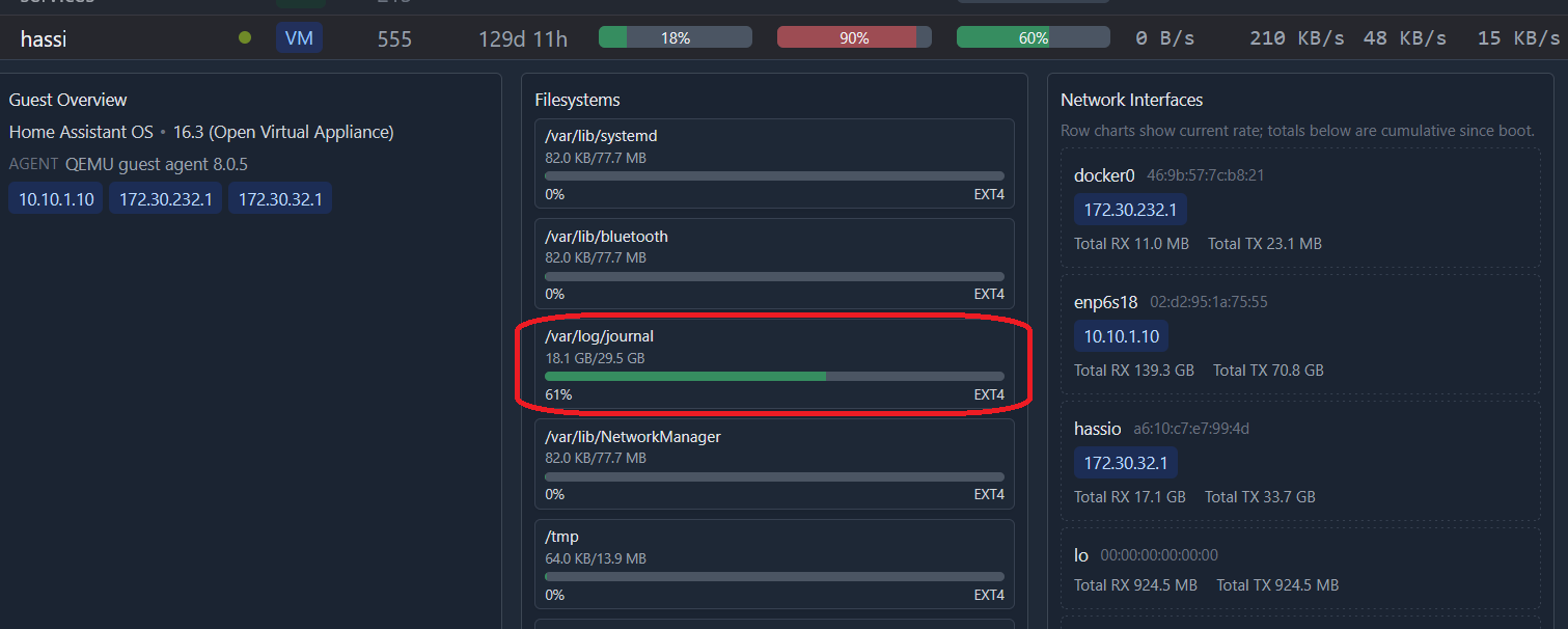

So I do not need to be concerned with
/ # df -hT /var/log/journal/
Filesystem Type Size Used Available Use% Mounted on
/dev/sda8 ext4 30.8G 18.6G 10.9G 63% /mnt/data
