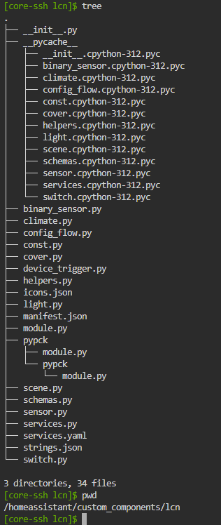

I’ve tried making custom_components directory with no luck… HA says it’s custom integration however, official python module remains in use.
module.py is the one I want to use modified

Hey, thank you very much! I was able to edit python modul on the file system and within container.
Somehow, I was struggling with generating proper keys using putty so I used ssh-keygen in my linux machine.
