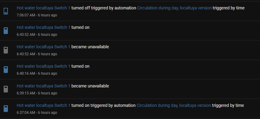

Recently I noted in the log a series of episodes where the OFF command was ignored because the switch became “unavailable.” The reason for this is unknown.

What would be the frequency of these OFF attempts in its current code? I was thinking I should probably put a delay between these requests. Would I simply insert a delay command after the OFF command?

You might be overcomplicating stuff with repeated commands while your switch is unavailable.
All you really need is an automation that starts out like this:
triggers:
  - trigger: state
    entity_id:
      - switch.hot_water_localtuya_switch_1
    from: unavailable
    to: on
Obviously, this is a stopgap until you address your disconnection issues, but it should do for now
