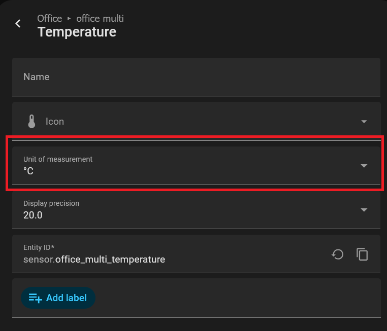

So @Nick4, I can set the temperature unit in the sensor for the temperature. However, the thermostat entity is self-contained and does not allow me to do the same.

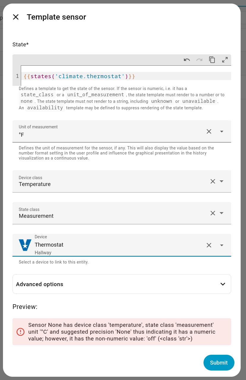

Hey @esand thanks for being so patient and sorry for being so stupid, but it doesn’t seem to work. It seems that the thermostat is a more complex entity and not just a single value sensor like temperature.

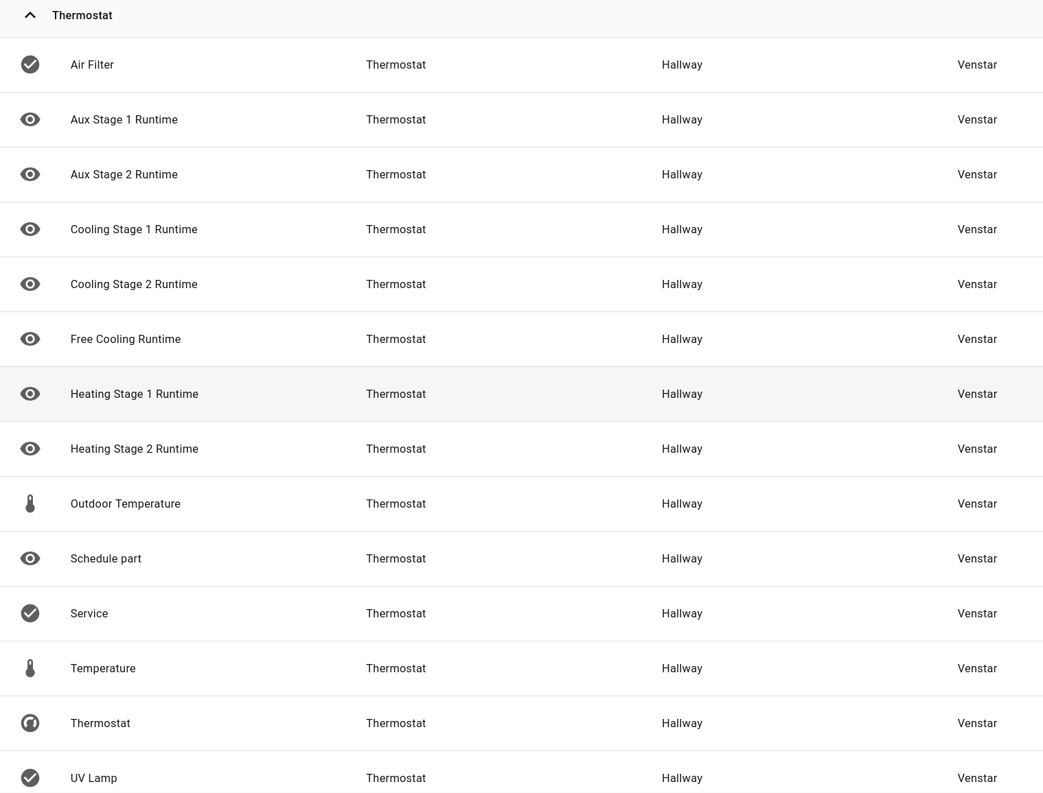

I have added some screenshots showing a) all of the entities provided by the integration and b) me trying to define a template. I also tried removing all other fields besides the “unit of measurement” and “state” but no luck so far.
My mistake - when you had said thermostat, I figured you actually meant a thermometer because you mentioned in the first post that you had a bunch of them.
If you still want to see if the template idea will work for you, to access the current temperature of a thermostat (climate device), use {{ state_attr('climate.thermostat', 'current_temperature') }}. It will return in the units of the thermostat, so likely C for your situation. To convert to F, a bit of math helps: {{ (state_attr('climate.thermostat', 'current_temperature') | float * 9/5 + 32) | round(1) }}.
