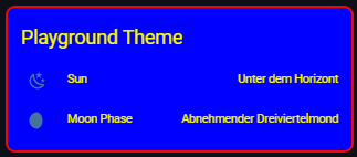

Here the theme.yaml
playground_theme:
  card-mod-card-yaml: |
      :host(.class_playground) ha-card {
        background-color: blue !important;
  primary-text-color: yellow
And here the code for the card:
type: entities
title: Playground Theme
entities:
  - sun.sun
  - sensor.moon_phase
theme: playground_theme
card_mod:
  class: class_playground
  style: |
    ha-card {
      border: solid 3px red;
Many things are working now, like:
“primary-text-color: yellow” from the playground_theme
“border: solid 3px red” from the card_mod
But class_playground is not working.
Is there still any bug in my code?
Did you follow the part of the card_mod guide on setting a card-mod-theme variable?
It’s not in the code snippet you’ve shared at least.
Thanks a lot, exactly this was my bug.
I played with so many playground_themes now, and the other ones had it, just this one was missing it.
playground_theme:
  card-mod-theme: playground_theme
Now I can start investigating, what all I can do with this great card_mod themes.
Thanks to all of you who helped me, doing this first step.
It seems to me, that the card_mod class is overruling all other settings.
card_mod class has higher prio than card_mod style => OK
But why is primary-text-color from the theme no longer working?
This color should stay yellow because no class setting is overruling it.
Is there a way to combine theme settings with card-mod class settings?

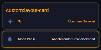

I have now managed to apply a card-mod theme to many cards, but not to custom:layout-card.
It seems that for this card I have to modify something in the DOM string.
Here is the theme.yaml where an orange box-shadow should be applied.
orange_theme:
  card-mod-theme: orange_theme
      :host(.class_orange) ha-card {
      box-shadow: 0 0 5px 1px orange;
  card-background-color: "#161925"
  primary-text-color: orange
And here is the card.
type: custom:layout-card
layout_type: custom:vertical-layout
layout: {}
cards:
  - type: entities
    title: custom:layout-card
    entities:
      - sun.sun
    theme: orange_theme
    card_mod:
      class: class_orange
  - type: entities
    entities:
      - sensor.moon_phase
    card_mod:
      style: |
        ha-card {
In the upper part, the card-background-color and primary-text-color from the theme is applied, but not the orange box-shadow via class_orange.
In the lower part the box shadow is created via card_mod directly.
My question is, what do I need to change in the following line: :host(.class_orange) ha-card
to make my card-mod theme also work for custom:layout-card, because for all other cards it’s working.
custom:layout-card fits the application note as per streamlined card. For this situation use dual selector approach.

    card:
      type: custom:auto-entities
      card:
        type: entities
        card_mod: # <- add card_mod here
          class: class_orange
      filter:
        include:
          - entity_id: '[[ENTITY_ID]]'
            options:
              type: custom:template-entity-row
              card_mod:
                class: class_orange
      sort:
        method: state
        count: '[[COUNT]]'
      # card_mod:
      #   class: class_orange
Thank you so much for your detailed explanation, it’s working now.
I will still need time to understand all the topics you have explained, but a big step forward of understanding how card_mod is working I’ve now done.
