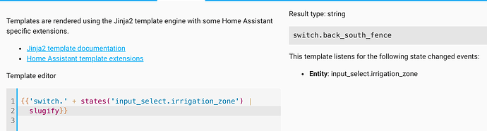

Here’s the template in developer tools showing the expected output:
However, when called from the Mushroom Template card, I get the following error message: “Failed to call service script/quick_run. Template rendered invalid entity IDs: {{‘switch.’ + states(‘input_select.irrigation_zone’) | slugify}}”.
