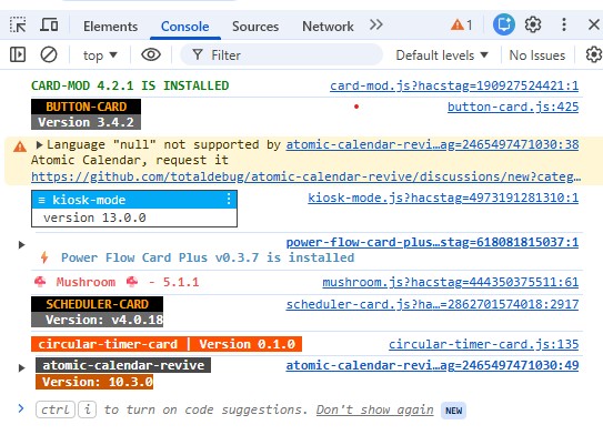

Here is mine: Seems to be an older version.
When I open the hacs-integration, I do not discover a custom:button-catd-entry. Indeed it seems I did something wrong while installing.
Yes, don't update it now, as other things might break. I'll try to check working syntax.
Edit: the oldest version available in HACS is 5.0.0, so that's a dead end. I don't think you should use such an old version of the card, so maybe try some of the suggestions others have.
If you really want to stick with this old card - it complains about the entity_id, so you could try variants like (try without any code, just "normal" actions, and if it works, then add the code):

But how can I update to the latest available version. I think I do not have so much buttons built with the integration, so there is not so much stuff which can break. Your version is 7. How to get it, outside HACS?
The reason for meesing with the button card is that this solution would best fit in what I already have. The button is just one of three different triggers for my automation. So if I could solve the button-issue everything will work fine.
Your solution might work even better but I have to deal with it in detail. And I might have to rethink my whole automation.
Maybe in the end it turns out that I will pick up your idea. Thank you for your help!
According to the button-card documentation you just need to replace the .js file and clear your browser cache.
You could also remove the old button-card (.js file and dashboard resource), and then reinstall it via HACS.

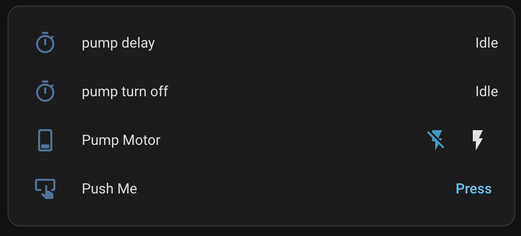

Completely untested, but the same thing....
Updated example without all the typos:
$ cat config/packages/foo.yaml
timer:
  pump_turn_off:
    restore: true
  pump_delay:
    restore: true
template:
  # Just to mock up a fake switch
  - switch:
      - name: Pump Motor
        default_entity_id: switch.pump_motor
        optimistic: true
        # hasn't been updated yet...
        turn_on:
          - stop: ''
        turn_off:
          - stop: ''
  - button:
      - name: Push Me
        unique_id: push_me_button
        availability: "{{ not is_state('timer.pump_delay', 'active') }}"
        press:
          - event: turn_on_pump
automation:
  - id: control_recirc_pump
    alias: Control the recirculation pump

type: entities
entities:
  - entity: timer.pump_delay
  - entity: timer.pump_turn_off
  - entity: switch.pump_motor
  - entity: button.push_me

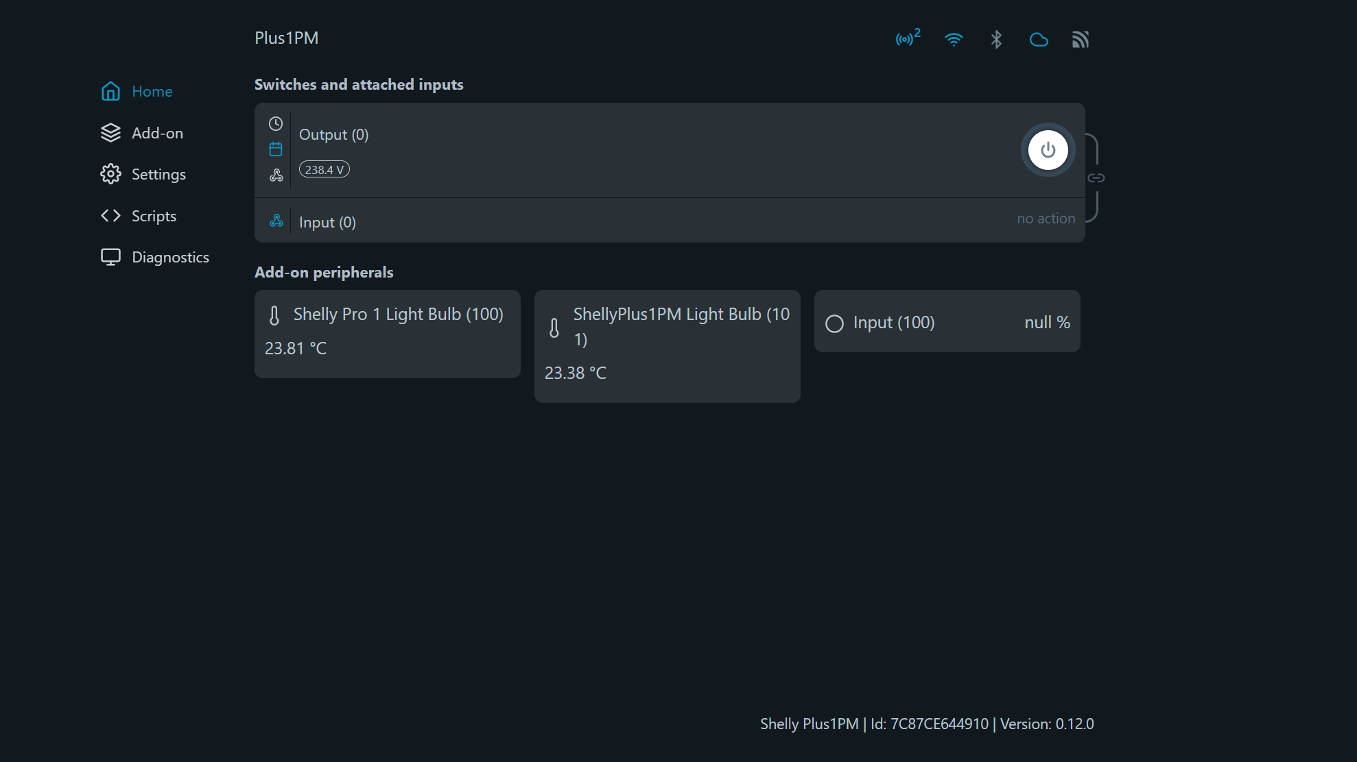

I am going to assume that you have a Shell Plus 1PM
The manual for that says it has a configurable "Auto off" feature.
So you can just configure your hardware to turn off after 3 minutes.
That dramatically simplifies your automation requirements, to the point where you can do the entire implementation with a single template switch:
