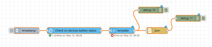

I have this WF:

and I am trying to use a Render template node to get the data I need from the Get entities node like the friendly name and the state. I will use the resulting payload within a Call service node to notify all my devices. Right now I keep getting the following error:
“Error get-template: Request failed with status code 400”
But I am not sure what is wrong, can I get some ideas and/or help?
