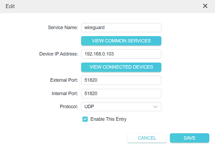

I seem to have misconfigured the wireguard add-on. I cannot access the Internet and home assistant. I have have done port forwarding on the router.
My wireguard add-on configuration looks like this: I use the public ip address from ips as the host (in the example I specified a different address for security).
