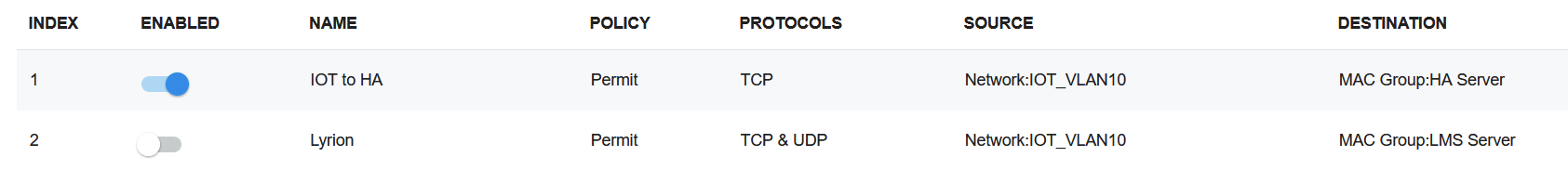

This is a really thorough guide, thank you @sliptdisk. I am part way there using my own logic of what should be able to access what using a full TP-Link Festa setup which consists of an FR365 Gateway, 3 FS308GP switches and 2 F65 APs.
The Festa system separates Network Security into Gateway ACL, Switch ACL and EAP ACL.
At the Gateway level, I can setup the “global” rules between my Private, IoT and Guest LANs.
I have to use the Switch level to be able specify the IP address (or MAC address which I have used) of my HA server:
This all seems to work for Home Assistant. I created second Switch rule because I thought about placing my Squeezebox Touch and Radio on to the IoT VLAN by binding the switch ports that they are connected to to the IoT VLAN and then allowing those ports access to the NAS box running Lyrion Media Server but that didn’t work.
Rule preference is determined by their order and rules can be dragged and dropped to change the order however what I am not clear on is whether a Switch rules takes precedence over a Gateway rule. Do you have any experience with the Festa system?
Lastly, I’m wondering why you suggested creating Rule 3 since the Private VLAN has full access to the IoT VLAN and Rule 4 since those devices are in the same VLAN so can access eachother anyway?
